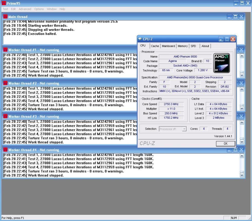

Kleines Update
250 |1.28 |2750 |GA-MA770-DS3| 9500 |0749 CPWM|LuKü|daysleeper83
*still testing* :xmas:
