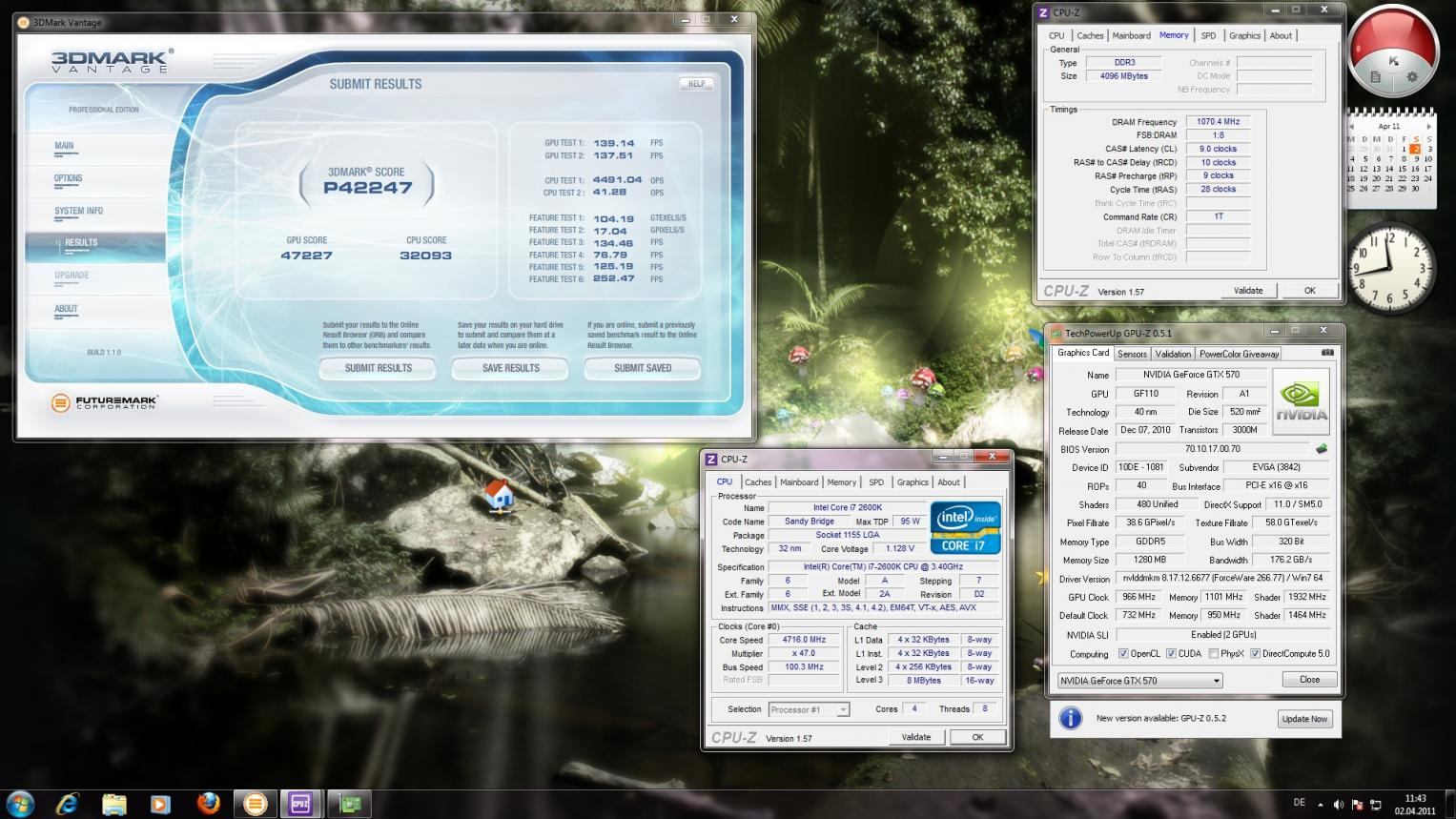

widder0815 - WIN 7 64BIT - Core i7-2600k@4,7GHz - Asus P67 ws Revolution - 4GB DDR3 2133 - 2x Geforce GTX 570@-966-2200 - P42247 - NO PhysX http://www.hardwareluxx.de/communit...rk-vantage-benchmarkthread-266.77-vantage.jpg
