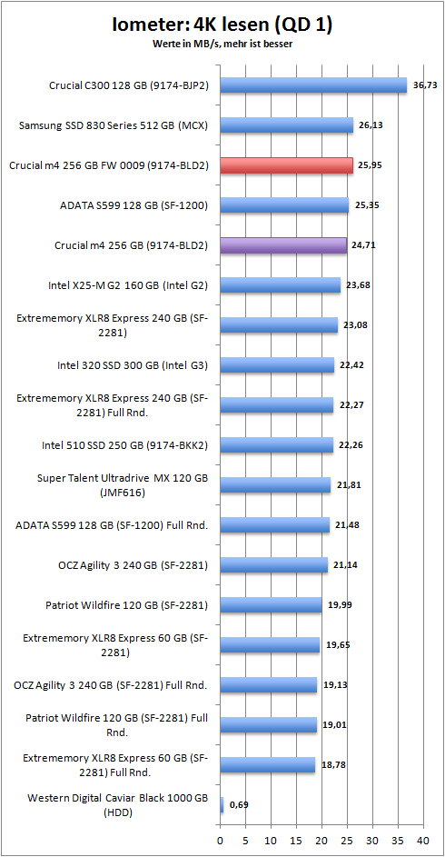

iometer_4k_read

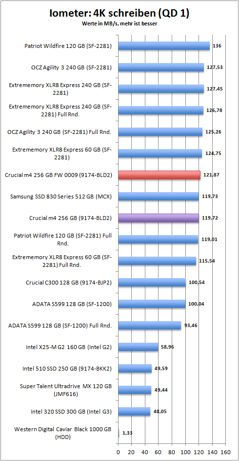

iometer_4k_write

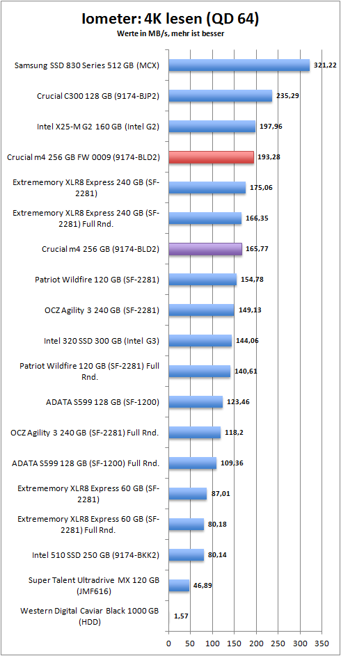

iometer_4k_read_64

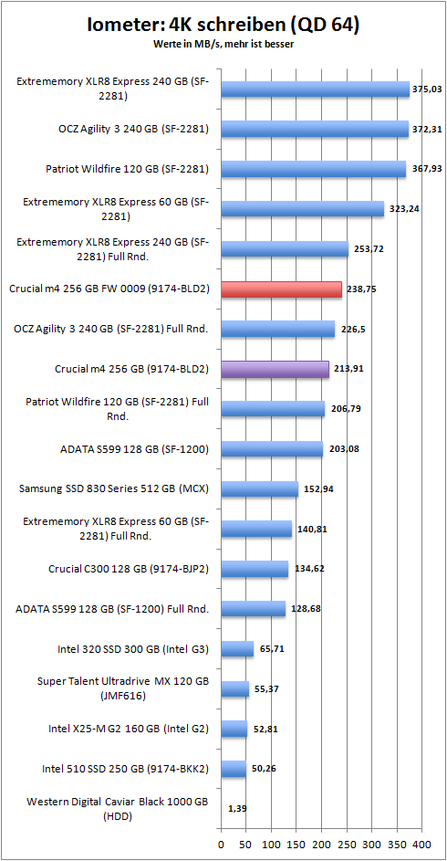

iometer_4k_write_64

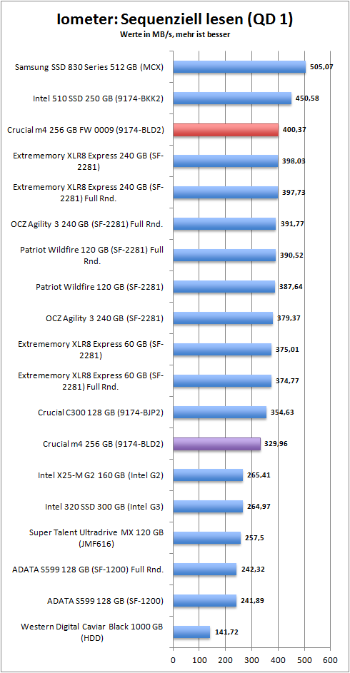

iometer_seq_read

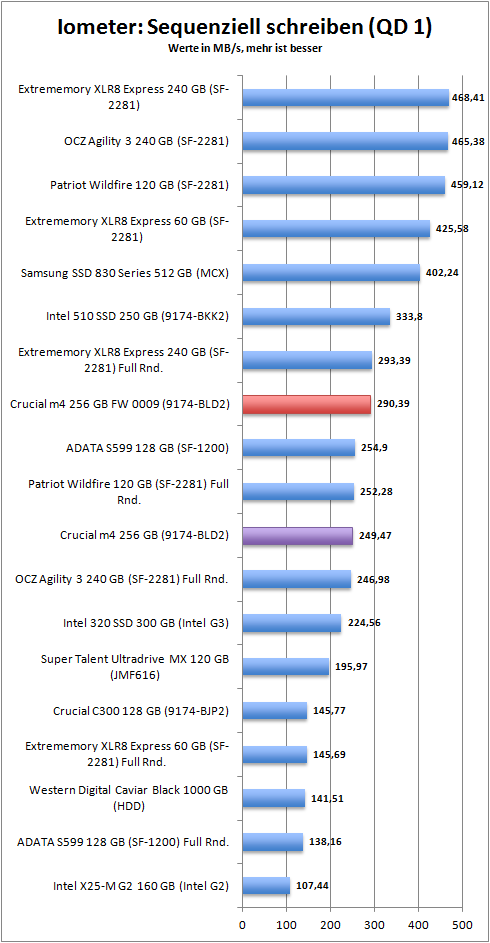

iometer_seq_write
