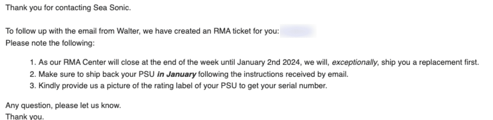

Seasonic 1000W gegen 1300W ausgetauscht...der Mist läuft wieder :d

OC hatte ich ja zurückgesetzt, die 1000 W waren wohl auch nie das Problem. Seasonic war da sehr transparent:
The your first power supply (mein altes Prime TX1000) is based on ATX 2.53 Design Guide of which the RTX 3090 should conform to in respect to power draw but unfortunately, it does not.
The unit you just received (SSR1300TR2)
is based on Intel’s newest ATX 3.0 / PCIe 5.0 Design Guide and has a greater latitude in power draw acceptance which means is can handle the demands of the RTX 3090“
