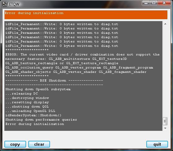

Enemy Territory Quake Wars
Hi,
Ich habe Windows Vista 64 bit Ultimate,habe das Enemy Territory: Quake Wars drauf und lauft nicht...Bekomme immer die gleiche fehler meldung...
Lauft es bei euch mit einem 64 bit sytem,müsste eigentlich...
Fehler meldung habe ich ein Pic im anhang...
Grafikkarte hab ich eine 8800
Gruss Markus...:wink:

Hi
Hi,
Habe vorhin erst den neuen Beta drauf gemacht...Habe den Sammel Fred garnicht geschschaut oder bessergesagt nicht mal danach geschaut sorry...
163.44 Treiber...
Hi
Hi,
Habe beides versucht geht beide sachen nicht,auch der neue Treiber geht nicht der 67...
Hy,
hier die Lösung:
"The reason for this is that if you've told your drivers to force DXT1 textures to be DXT3 (via a registry/inf tweak) you will get this error. You need to turn this off.
The reason for this functionality existing was because of a hardware issue with the original GeForce (which you obviously don't have) causing artifacts on hardware decompressed DXT1 textures.
By enabling this functionality on any newer cards you'll be causing DXT1 textures to use 4 times as much memory for no reason at all. This increased memory usage might even degrade performance.
The way I found to disable this setting without reinstalling drivers (which is a pain for laptops) is as follows:
* Download (http://www.guru3d.com/index.php?page=rivatuner), install, and run RivaTuner
* In the "Driver Settings" section of the "Main" tab, click the triangle button next to "Customize..."
* Choose the OpenGL button from the pop-out bar
* On the "Rendering quality" tab, uncheck the "Compress to DXT3 instead of DXT1" box.
* Click the [OK] buttons until RivaTuner closes
* Restart your computer and enjoy ET:QW!
NOTE: It's necessary to restart, even though RivaTuner doesn't suggest so. I got really disappointed when I changed the settings and tried ET:QW with the same result, but decided to restart. After restarting, ET:QW now works great!"
Quelle: http://community.enemyterritory.com/forums/archive/index.php/t-1987.html
Gruss
Sascha
PS.: Hoffe ich konnte helfen!!
