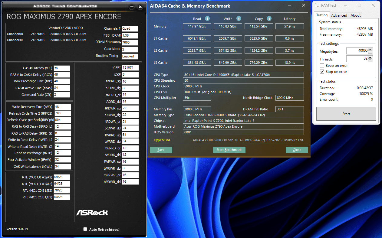

da ich mir am 8000er XMP Profil die zähne ausgebissen habe, habe ich vor ~einer Woche mit dem 7600er angefangen.
(ja ging ne weile, hab aber auch nicht täglich zeit gehabt, war beruflich ziemlich eingespannt...)
Durch viel lesen, rumprobieren und sehr oft ärgern hab ich wohl eine beim mir funktionierende Einstellung gefunden für 7600MT's:

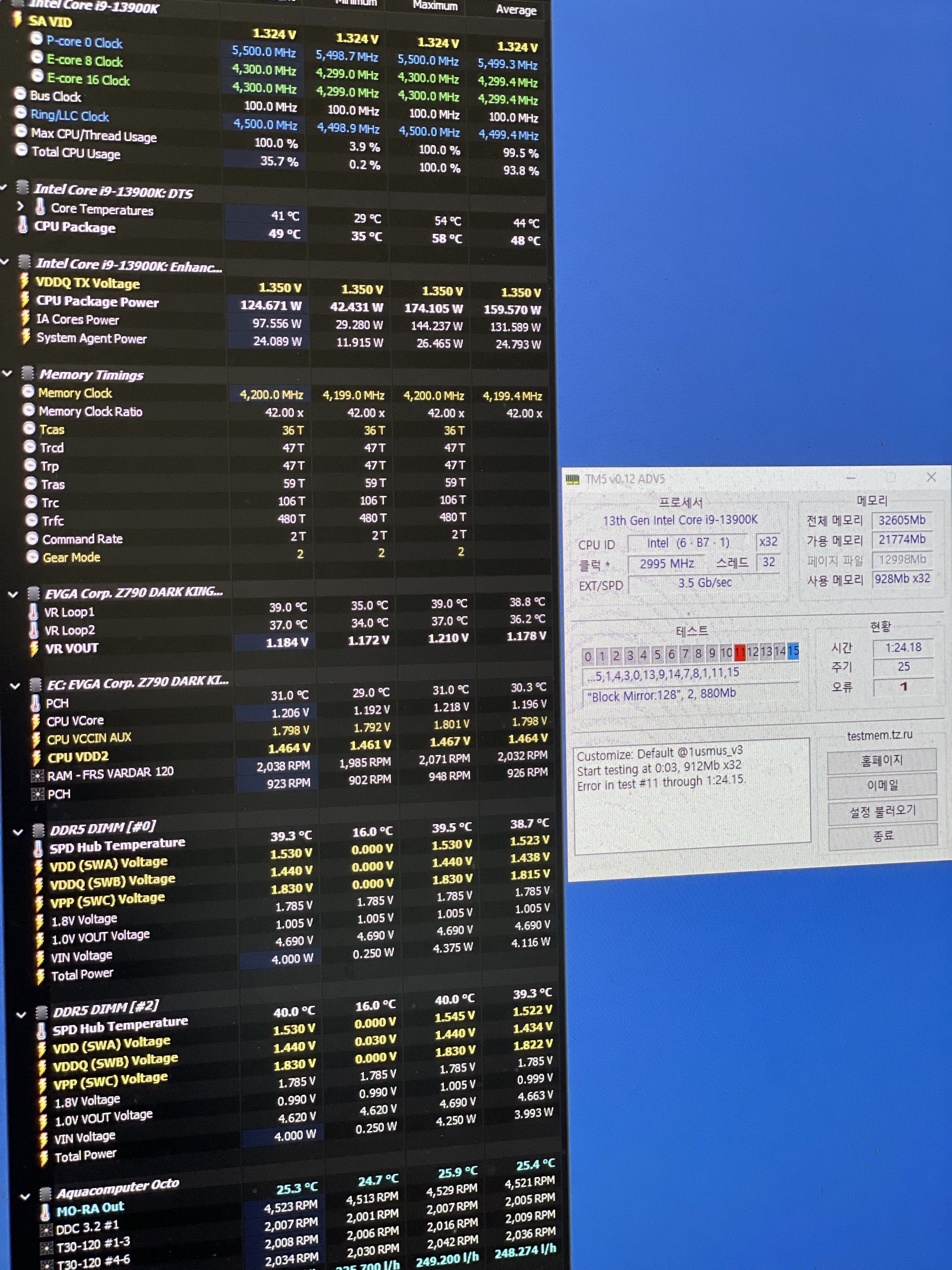

Aktueller Karhu zwischenstand:
Karhu passt auch :d

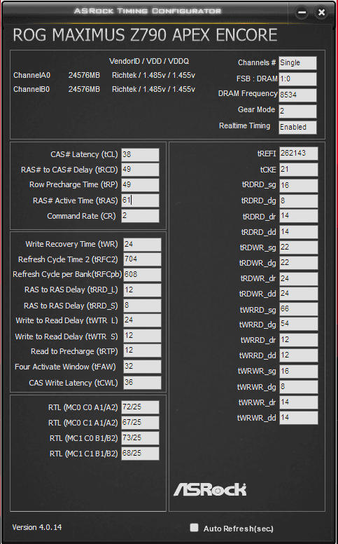

Hi Veii,
Do you have any idea where to start to fix the issue?
I know if I will start it by myself, I will just mess up the profile.:)
TX: 1.30V
SA: 1.18V
MC_VDD: 1.475V
DRAM VDD: 1.47V
DRAM VDDQ: 1.45V
VTT: 1.1V
CPU should be stable. Passed 2x 90 min on 8400C36 with the same setting.
CPU setting is P59x3 P58x5 P57x8 + 2TVB E45X R45-50X LLC4 IA_ACLL 0.22 ICCMAX 420A
Skews and training settings are default.
Hope you have an idea.
Thanks in advance!

I'm really not sure on that.
Very much not.
1.43 VID requests are guaranteed throttle
That ontop of ICCMAX being "low" normal , can mean it will hit it even faster
And that then will mean that it throttles even stronger and might actually lack voltage - even if you basically overvolt now.
PL4 (ICCMAX) also counts for DDR not only the cores
WTRS is a bit high for my taste but i think all is ok
RDWR SG/DG gives buffer. Same for _DR & _DD give buffer.
While i dont like some timings,
If TM5 says its ok, it probably is :)

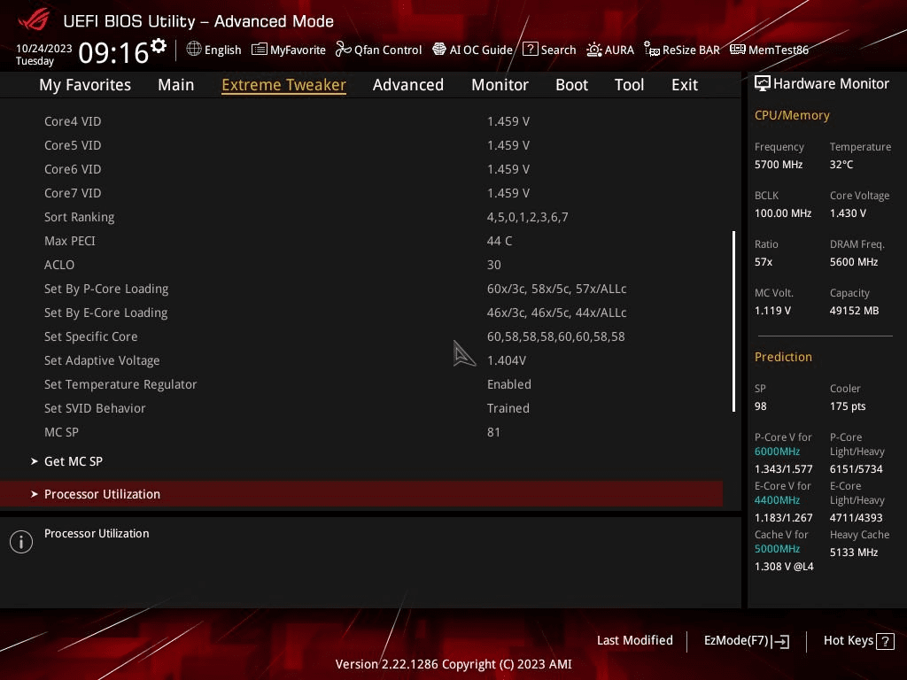

Any voltage offsets used besides TVB & IA_AC ??
What is VR_MAX on ?
Did you use anything for CTL0 Skews ?
WTRS is a bit high for my taste but I think everything is ok
While I don't like some timings,
If TM5 says its ok, it probably is:)

My VR_MAX is 1720 mV I believe.
I don't have Vcore Voltage offsets right now at all.

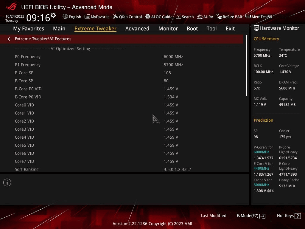

Here my CPU info
CTL0 skews are auto, didn't touch any skews yet. I had some experiments in the past, but no success yet.
MC SP is 84 now, these are old pics.
I will set offsets on V/F curve like @zebra_hun did, but I am really busy nowadays and that is very time consuming. Tought maybe it's okay if it's already passed several times.

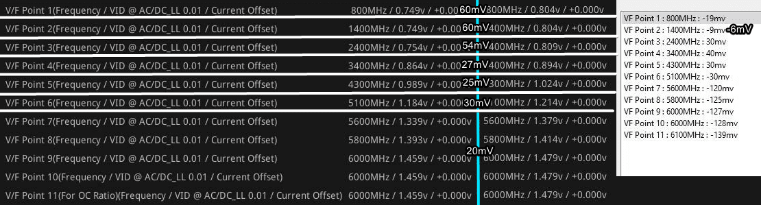

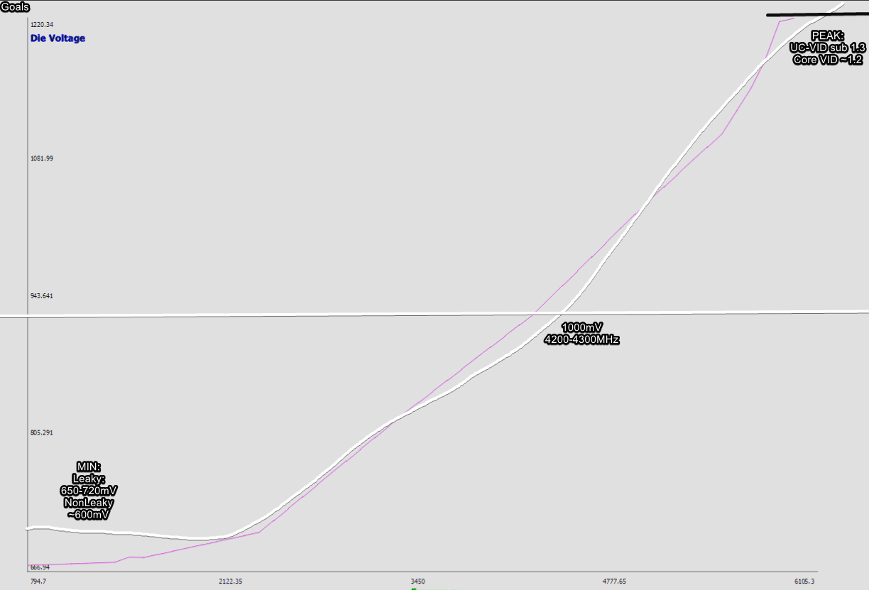

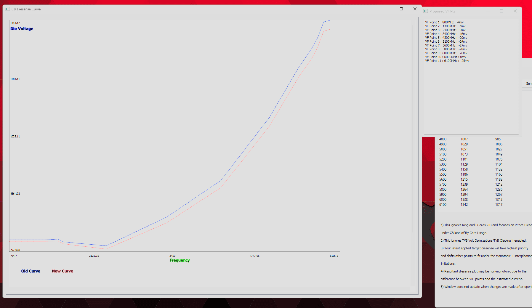

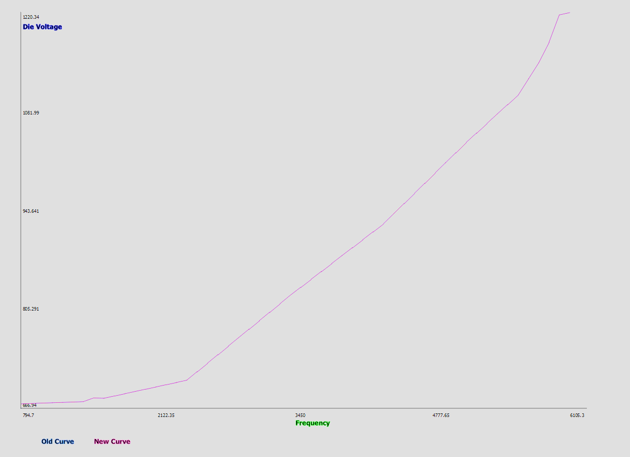

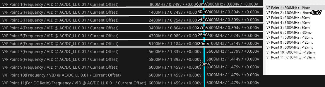

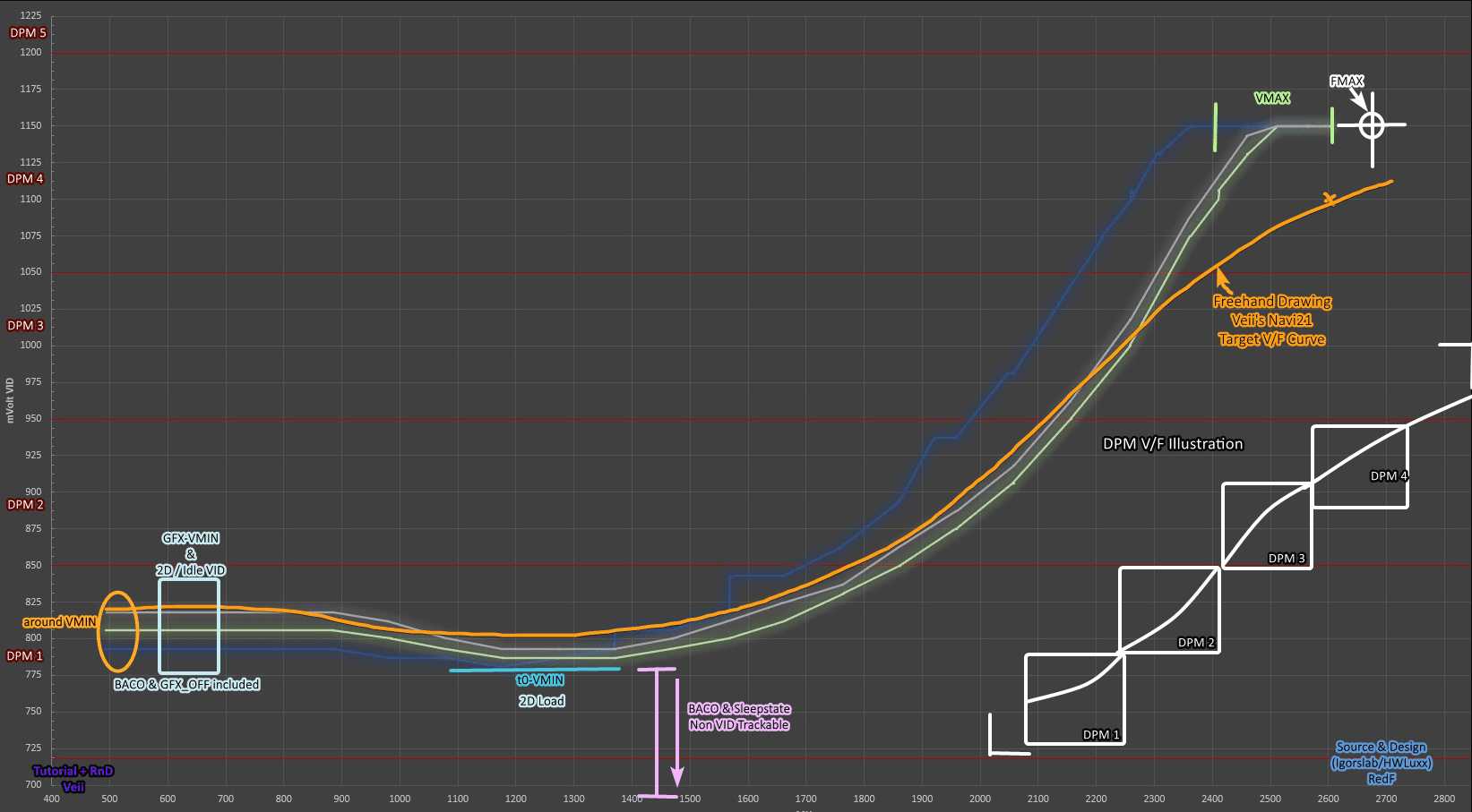

Soo probably start with
Code:
P1  ~ (-69)
P2  ~ (-66)
P3  ~ (-24)
P4  ~ (+12)
P5  ~ (+6)
P6  ~ (-60)
P7  ~ (-138)
P8  ~ (-142)
P9  ~ (-146)
P10 ~ (-147)
P11 ~ (-150)
Something along those lines :)
Down to 1550 for now

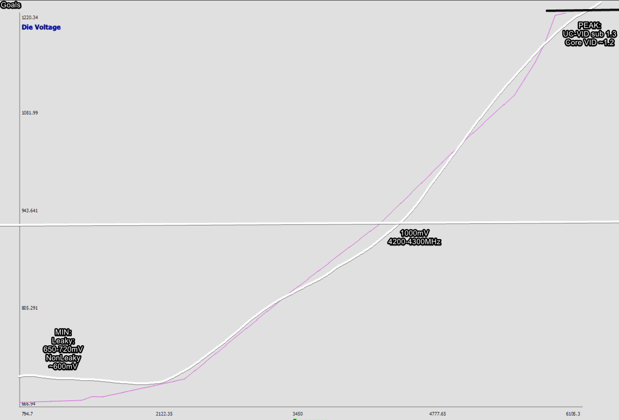

IA AC down to 0.35 for now

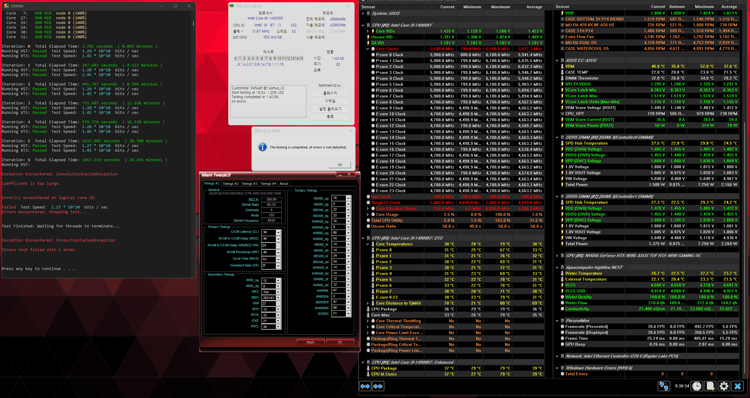

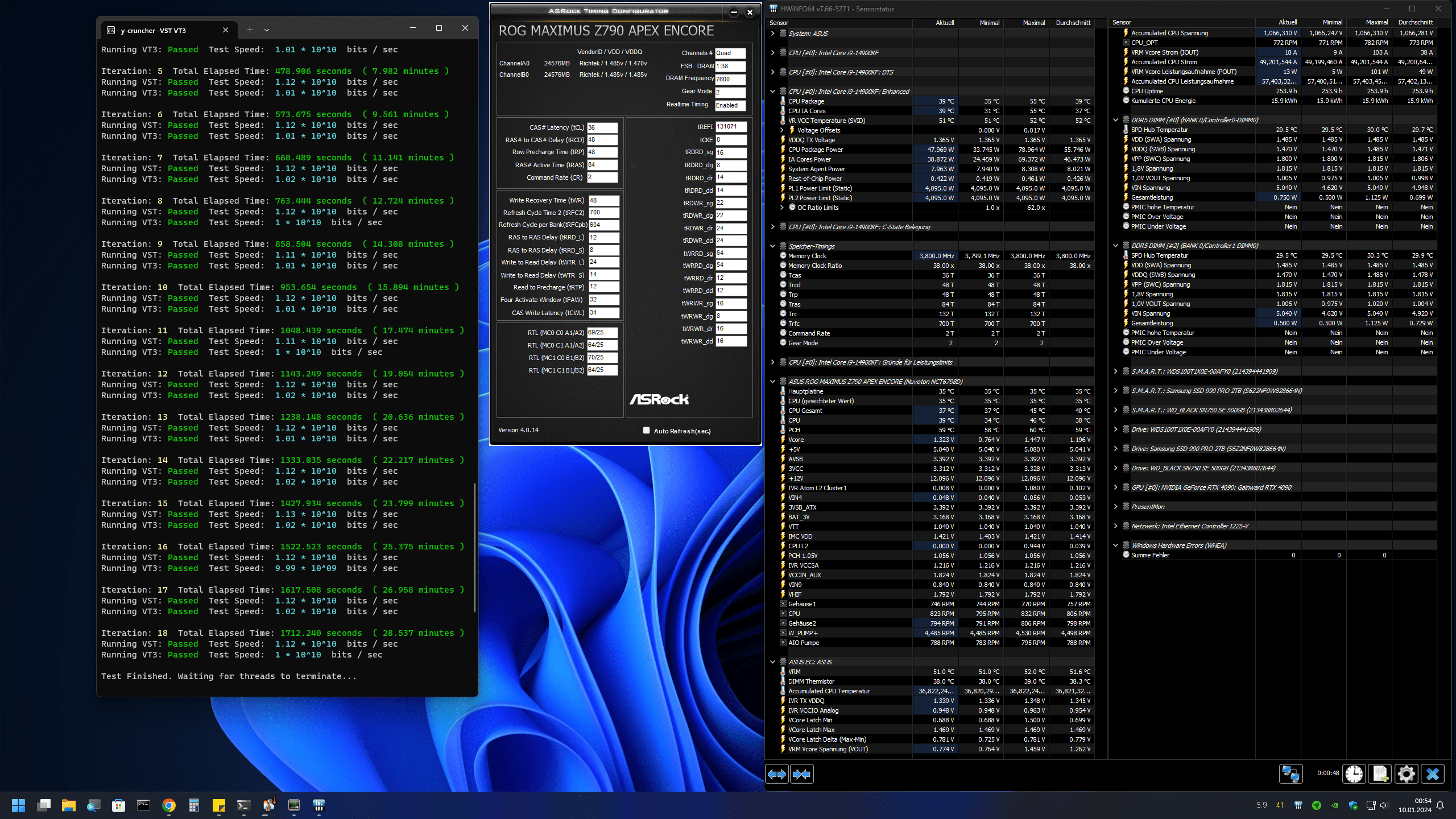

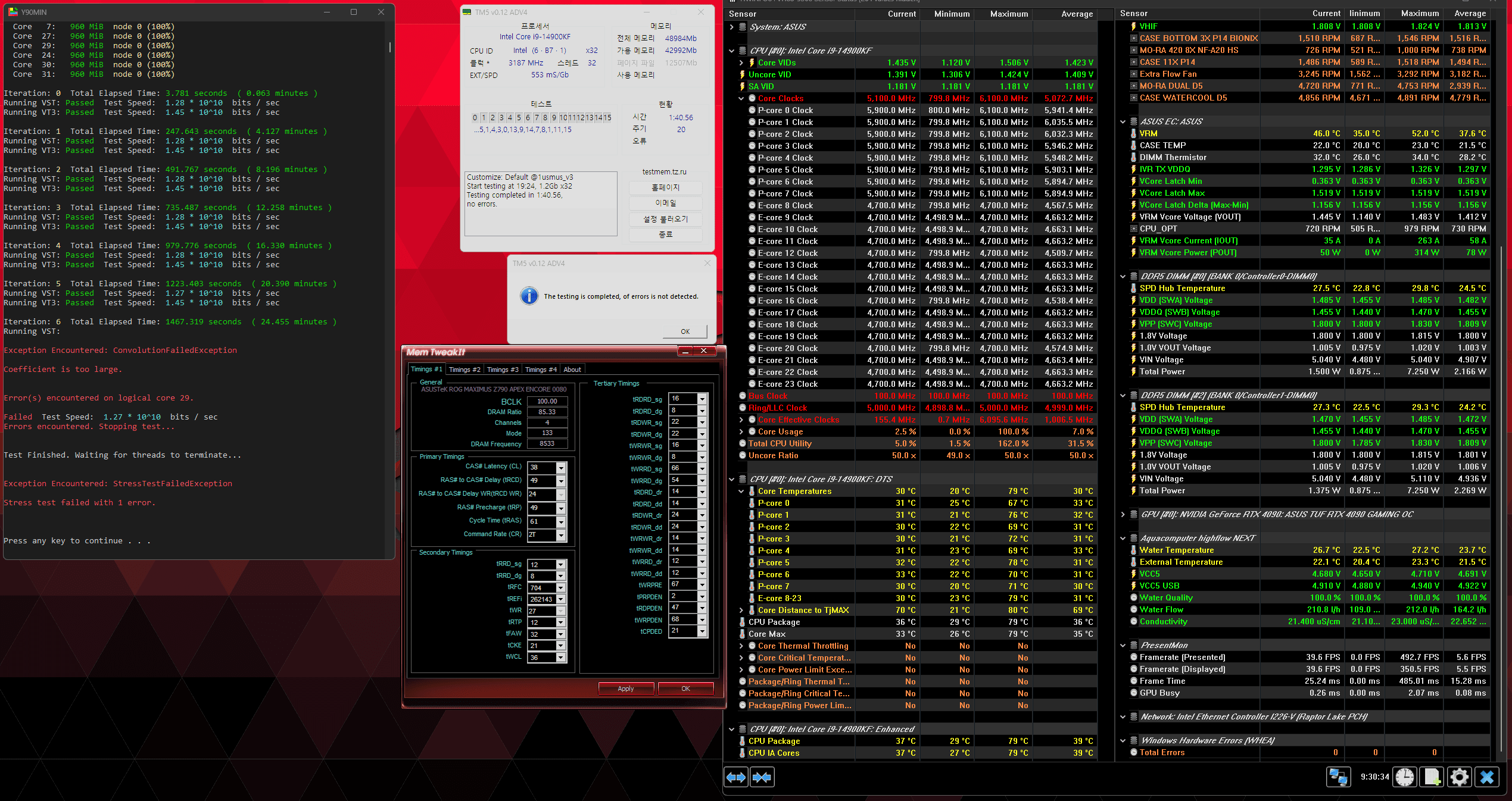

Then either give me a phone recording or capture somehow
SFT VST VT3 with HWInfo
Nothing else open.
You may also want to show it visually (before opening anything else)
on ASUS OC_TOOL
^ looks solid :)
You understood :giggle:

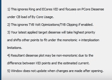

Your example
LLC4 IA_ACLL 0.22
Your problem arises, because IA supply factors 4 things in. At least
Its not only the the p-ccores, not only the e-cores , not only ring.
Real IMC voltage is not VDDIO.
Code:
P1  ~ (-69)
P2  ~ (-66)
P3  ~ (-24)
P4  ~ (+12)
P5  ~ (+6)
P6  ~ (-60)
P7  ~ (-138)
P8  ~ (-142)
P9  ~ (-146)
P10 ~ (-147)
P11 ~ (-150)
Nothing else open.
on ASUS OC_TOOL
Your exampleYour problem arises, because IA supply factors 4 things in. At least

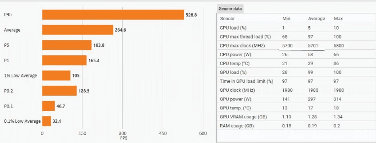

I searched a lot of results for Heaven Benchmark. ~40-50 fps is the minimum for everyone.
Ya but no :d
It differs up to CPU and GPU Manufacture
Around 50 is common, but 51 vs 55 is a difference for example.
And on bad GPU curve also can drop to 22-25 FPS :)

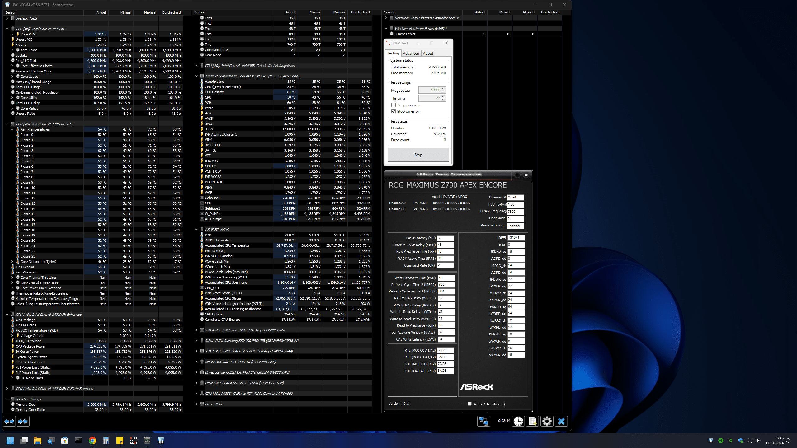

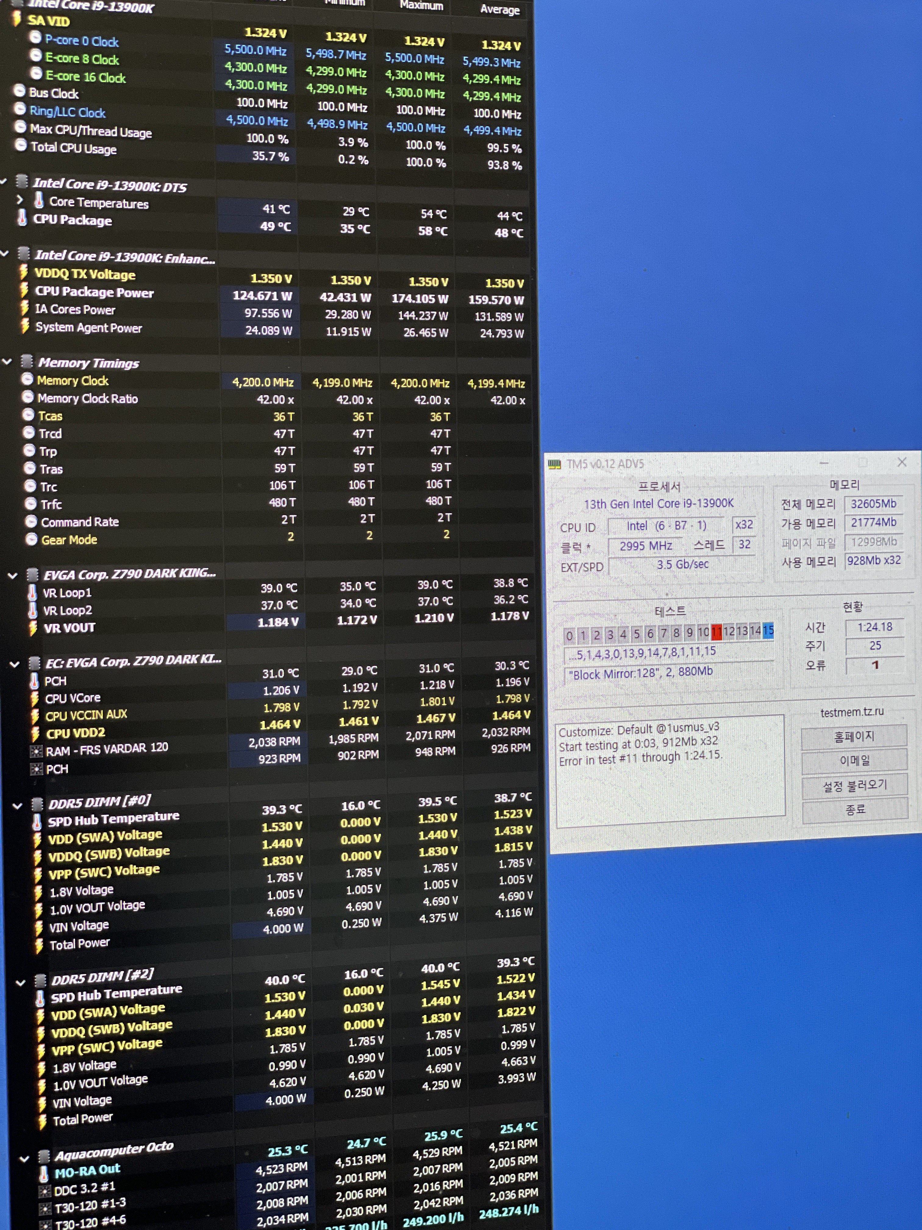

Why would you only test ~31GB in VST/VT3 when you have 48GB in total?
Hmmm
Moin :coffee:
Since there are 26 runs, there are 25 switches and fast charging, which is why the min fps is so low, since it also measures those.
All is on purpose
I need a weak CPU focused Benchmark which may or may not fit in cache
That runs CPU Clock dynamic
Which seems for you doesnt happen. Either due to powerplan or some other strangeness
Revi OS + Park Controll.
Didnt you say SpectreOS at first ? I'm on Revi the whole time and don't feel like updating // (this image is ~1 year old, and gets maintained)
It doesn't behave the way you described. Neither for Intel or AMD.

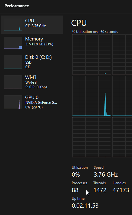

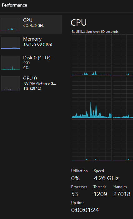

Wenn du alles schließt, auf wie viele Processes kommst du ?
88 wäre bei mir mit 28 Browser Fenster, Discord und das Screenshot Programm.

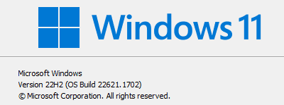

Guten Morgen!
Nein, ich benutze Revi OS Power Plan nicht. Nennt Ultra Perf.
Balanced ist besser. Damals habe ich das benutzt, aber Ultra bleibt standig max Takt.
W11 aber normal, wo ich immer getested. W10 ist Revi OS, aber ich werde beide OS neu installiert.
Jetzt aber beide OS funtioniert gut, gehen runter sofort 800MHz wenn idle ist.

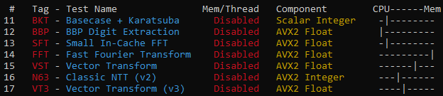

and hammers the IMC harder. This is not memtest,. It's IMC test
Unsure~ :-)
Y-cruncher itself is not a memtest.
But HCI/Karhu & TM5 are different kind of memtests which equally let Ring be utilized.
VT3 messes with:
~ E-Cores
~ Ring
~ L$
~ ^ Which then is offloaded to mem
Its not about what performs faster, but what loads the CPU completely.
14,15,16,17 has a target to fill Backend and MemSubsystem as best as it can.

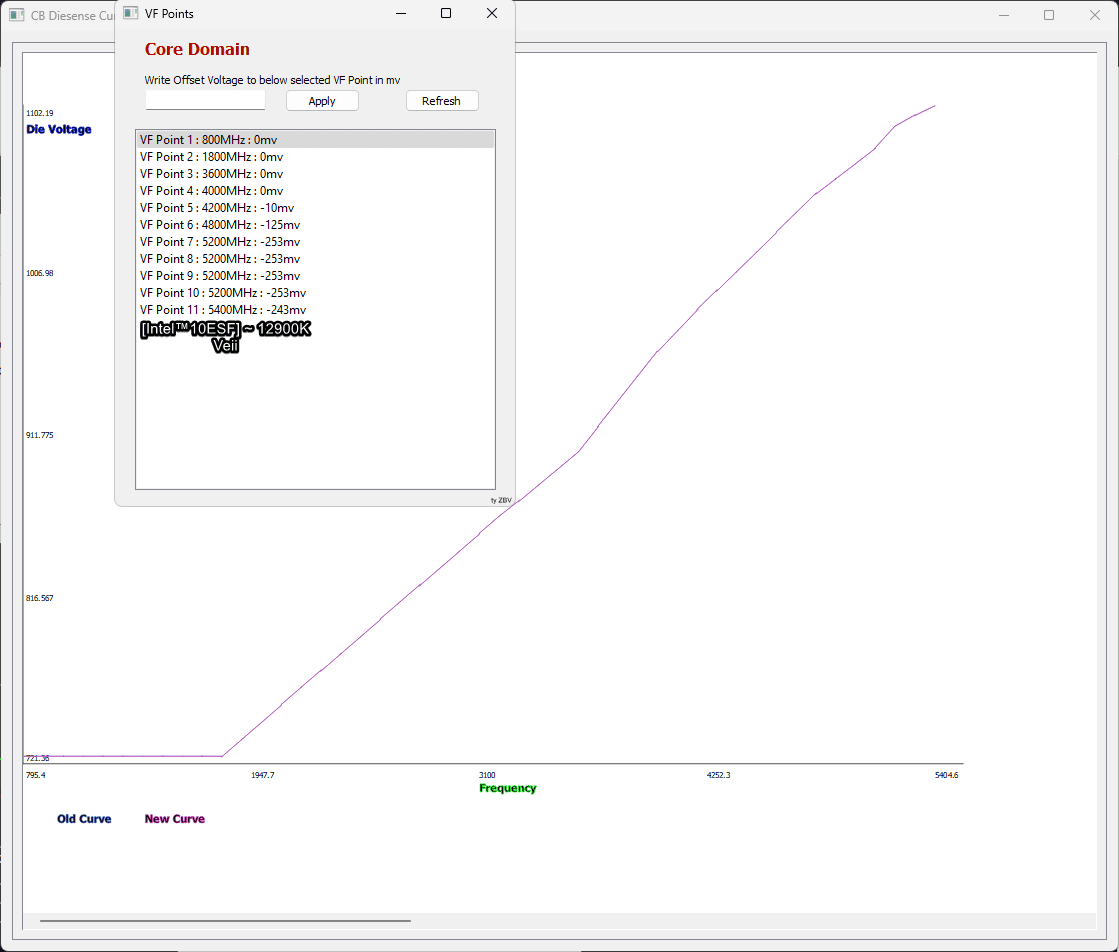

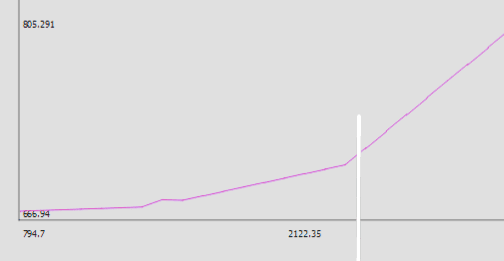

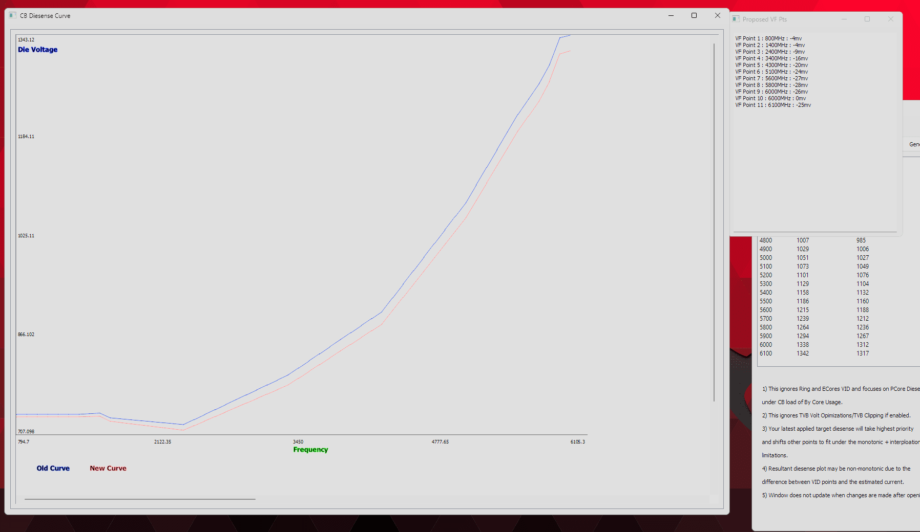

After inputting curve values , please share a visual curve before you start any tests.
I need to make sure lowest parts are ok, because you put me in a position to guess blind ~ to help you invest less time.
I don't feel like being Tech Support
But so far its ok~~

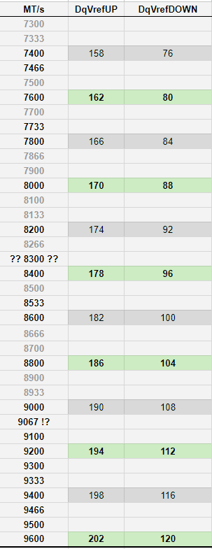

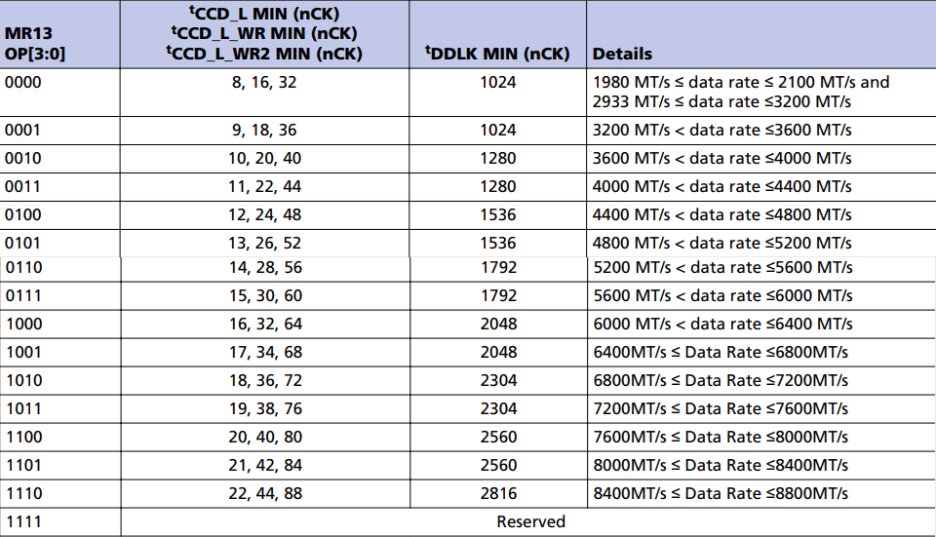

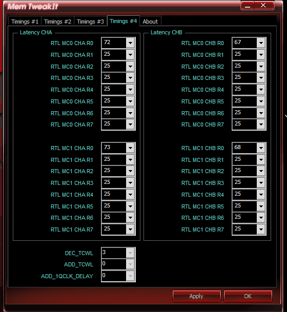

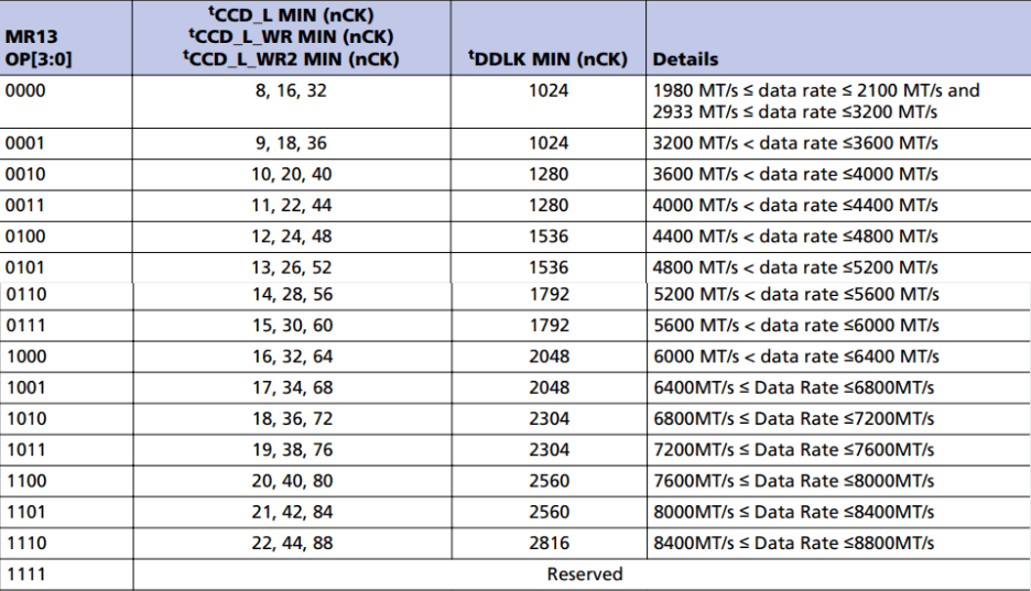

CTL0 DQ should be somewhere between (181-99 // 180-98 // 182-100)
Somewhere there, and before you/we play with them ~ we need to test CPU stability
That is SFT and doublecheck if something messed up on VST+VT3.
8533.33333(∞)4 , is such an unfriendly clock.
VT3 messes with:
~ E Cores
~Ring
~L$
It's not about what performs faster, but what loads the CPU completely.
I don't feel like being tech support
But so far it's ok~~
Need you to find a way to invest the time and work by yourself further, or not bother with it:)
I got no DDR5 system anymore.
That is SFT and double check if something messed up on VST+VT3.

Your values made my computer totally freeze, so tried to do it myself. Probably it's due to the AC_LL 0.35 (my bad.. :) )
My method was to use the CB die sense table from my "stable" profile and put that values into the AC_LL 0.35 profile.
So with using the suggestedd AC_LL 0.35 I needed smaller offsets than what you suggested.
Here is a video I made, just a small one, this SFT is not a funny load. :) (here is the one with the screen recorder: video )
A bit shaky, done it by hands. I made one with a capturer too, but that reduced the Y bitrate.
The bitrate on VT3 is much lower than what it was with my previous setting, even though the frequency is the same.
Probably something limits it.
Here is the default AC_LL 0.35 curve and the new one.
There is a drop on some small frequency which should be corrected later. But it's parallel with the default curve.
It is completely my fault for making a calculation mistake between P1-P3
A freeze is not bad
You do have 60mV headroom downwards.
I have to work blind and it was difficult.
Please retry my suggestion at 0.48mΩ AC_LL
That shouldd be plenty to make it to windows.
I need to visually see the curve, because there is a chance that i made a "between steps" mistakes.
Like 1-2mV off.
My math might have been 6-8mV off, but more importantly i need to check transitions & the ~2.5GHz curve.

At least on ASUS Boards negative VF-offsets do not work.
Highest voltage wins.
Learned on 12th gen, it changed with 13-14th gen.
Basics remain. 12th gen had individual points.
13-14th gen algo is more dynamic. Every point influences the other.
13-14th gen also need to be careful with transition steps.
Please read those notes carefully. Point 3 & 4

Hey,
Thank you for the answer!
Updated the settings acc. to your values and AC_LL 0.48
The slope looks much better for my eyes, let's see the SFT. :)
Wait for my answer pls :)
I need a visual inspection and as thought
This drops far too low
Sec~
You can sanity check FFT for like 6-7 loops
Give it minimum 15minutes.
Till i get something
I just came back home :-)
Am free for 2-3 hours. DDR4 Shenanigans passed.
I'll try to be a bit (tech) productive today.
Share your setting in our hun Forum, too.

Goal
But we lack E-Core and ring curve-access.
There is still plenty for work open. Need to work with supply offsets for Ring & E-Cores
Wait for my answer pls:)

I ran a bit forward, but I will leave the PC soon.:)
I was able to boot with the IA AC 0.48 but it was insta BSOD with SFT. But I slowly raised the AC to 0.68 and I can pass. Load Vcore on SFT is 1.199V
New videos: capture , phone
Voltage is lower, but no more limit reason, which is good.
Bitrates are still far from my previous tests.
Can you give on this a scroll capture, phone or merging two screenshots
Of the listed (target) DieSense (VID) for every 100MHz step ?
The written out values, just to be sure :)
We target near 1150mV CoreVID or 1160ish Vout.
Around 1180 for VT3.
We hit atm 1230 Vout
But its not just "lower one point"
if you lower one point or transitions are bad, it will crash.
Target is to lower min and mid points, to smooth peak ~ soo overall whole curve drops.
LL(C) Telemetry faking is a linear drop. Substrate has not linear voltage scaling.
I need you later to check bootable high-voltage.
To make sure you have same very-leaky but XOC SA/MC stable chip.
Nonleaky are very different than those 1.46+ ones.
Some are high leakage some are just "failed" bad bins.
Some need high voltage curve due to thermal target, some 14700K rebrands need more voltage or fail target clock
There are many variables why it is how it is.
Important is that ICCMAX is not hit, for any of those harsh loads.
PL4 itself will bother for memOC. Its not just the cores~
// But it has to exist for health, safety and for jitter/transient loadchange spikes
We can fake and bypass, but if we start putting bandaid on bandaid like PLL usage - this leads to nowhere
