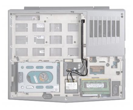

My German colleagues, first my apologies for writing in English but I have been following your excellent discussion on WWAN, and I don't want to insult you with some dreadful google translation :-)
I note in the service manual it seems to show 2 antennas but the picture that your colleague provided of the inside of the laptop does not show it the antenna installed and I think Dell are stupid for doing this.
My question is for those who have ordered, I note on some of the orders that the yanks have placed they have a line on their order that is like this:
430-3773 1 No Internal WWAN Antenna Installed
but my UK order doesn't have this line. I wondered if my great friends here in Germany had this line in their orders? I may be "grasping at straws" but I am still hopeful that the WWAN antenna will be installed on my machine.
I've ordered a WWAN antenna that clamps onto the mPCI card (noted in the thread above and will report how well it works).

here is a useful picture from the service manual that made me think the wwan antenna was installed:
WWAN cannot be ordered via Dell.de as well. It also seems that the antenna has been removed (both cables are missing). Im going to take a deeper look and try to find out whether they just hid the cables or completely removed it.

This line is missing on my order. Just did a dissassembly and the cables are defenately missing.
In deutsch: die WWAN Antennen fehlen komplett und sind nicht versteckt...

Ich würde also allen die das lüfter an-aus problem haben mal raten zu prüfen wie die cpu auslastung im idle mode (also wenn kein desktop programm cpu braucht) ist.
