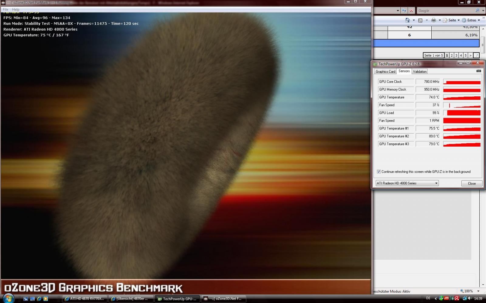

Forced 3D 4870 / Accelero S1 + Turbo Module / 780-950 / 75,5-89-79 Grad
