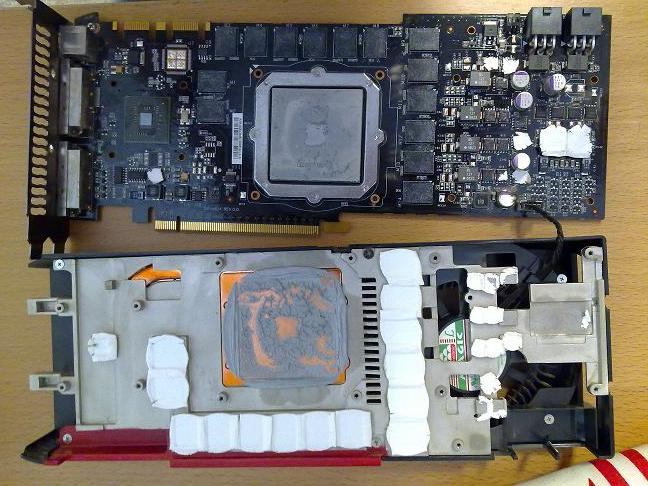

Ok finaly i have the pictures of the card i want to get, it was difficult to get these. I did call EVGA in stuttgart if they could send me the pictures without heatsink of the EVGA GTX260 sc 55nm (896-P3-1257-ER) after some calls they finaly send these pictures, good customer support ^_^. So can you or some one else tell me if this card can be watercooled with a full cover block, and wich brand EK?
Thanks in advance
Thanks in advance
well in my opinion it is pcb-design "P654". so you have luck!
just look into the firstthread...there you can see the pcb-numbers and some fittig coolers:
for P654:
- Aquacomputer aquagraFX 260GTX 55nm (G200b)
- EK Water Blocks EK-FC260 GTX SLI (55nm G200b)
so that is your choice! in your situation wait, whether the other users command your pcb-design and say "yes it is P654" !
and then buy this card and try to look on the pcb before you buy the cooler! then you could be pretty sure that it will fit!!!
for P654:
