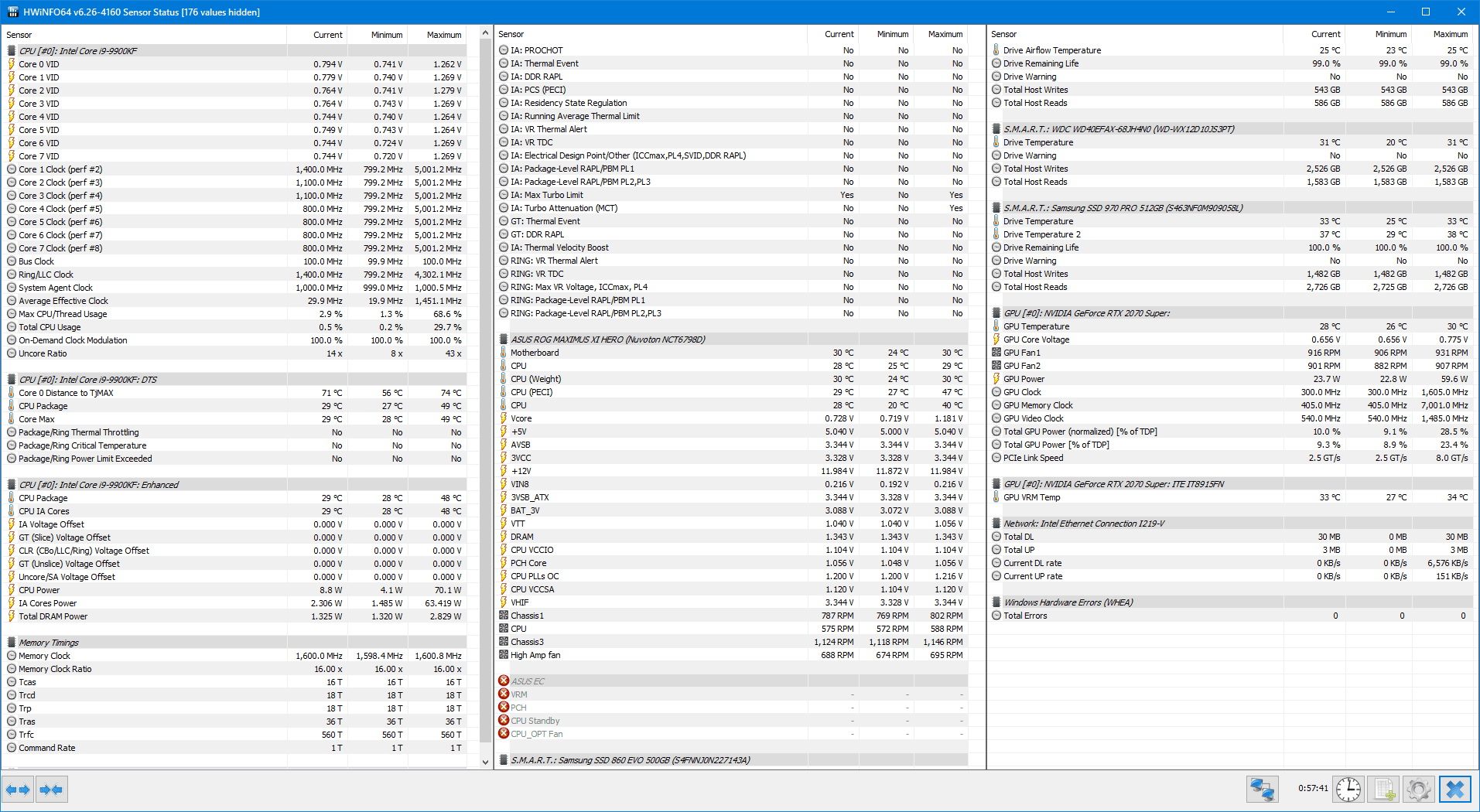

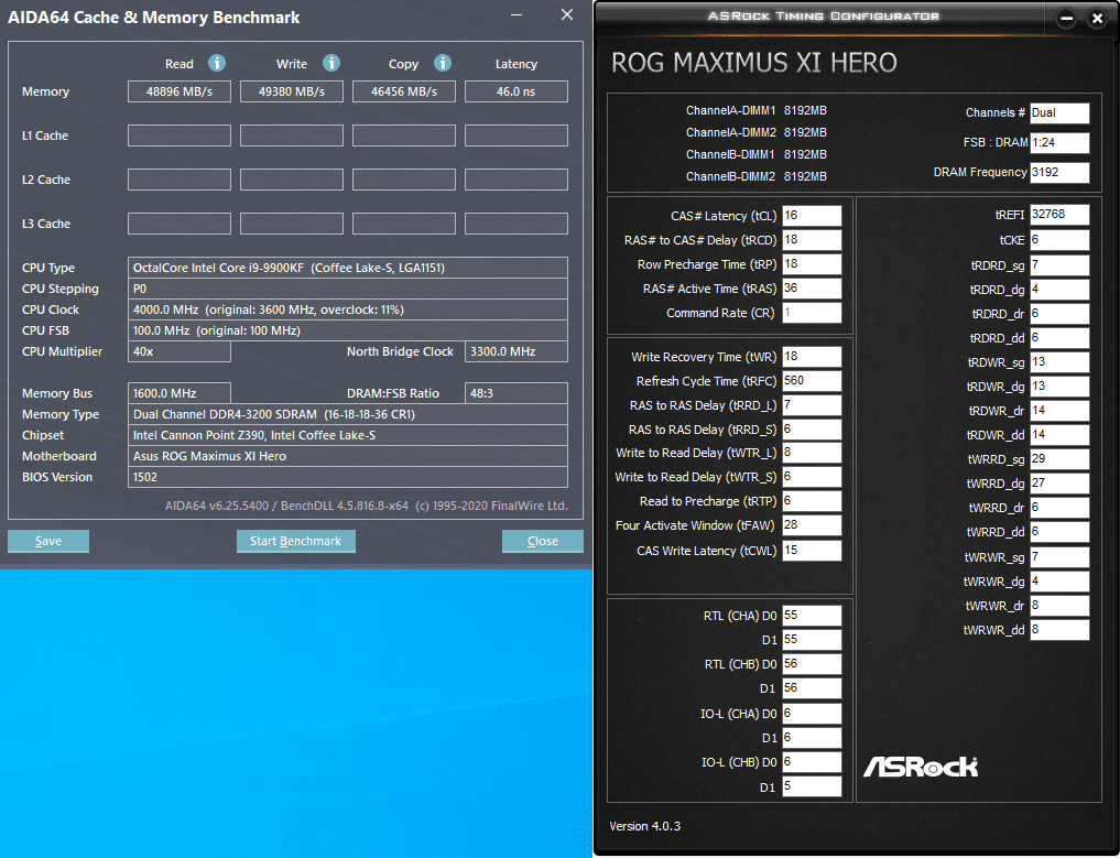

I got 2x16Gb of CMK32GX4M2B3200C16R 4.32 with Samsung C-die onboard and it runs stable at 1.36v3400@16-19-36CR1 on my Maximus XI Hero. I can start it higher to the point of 3600@18-20-20-38 but I was not able to commit any of results with tests.
Recently I've got similar HyperX Fury kit as Olan (HX432C16FB3K4 / 32) unless I have kit of 4 single rank modules. I bought it relatively cheap with one goal in my mind - to get 3600 or similar on my motherboard, as far as I found that T-topology allow you to get higher results using all DRAM slots. But I was surprised that with new Kingston kit I can't even able to get 3300. In point of fact, it get unstable even if I reset BIOS to defaults, set Manual overclocking profile and copy some or all timings using Asrock Timings Configurator from stable XMP run on 1.35v3200c16.
I also tried to use Rysen DRAM Calculator with Samsung OEM layout, tried to play with timings/subtimings, DRAM voltage and VCCIO/VCCSA in range of 1.05-1.35, with RTL IOL block, and it did not bring any results for me in matter of 3300+.
I know that the most likely problem is that I'm doing something wrong. Thank you again.

Try 1,45V DRAM 18 22 22 42 3600mhz. If that is helpfull you can lower timings and voltage to your liking. I would try to get a higher frequenzy and lower timings first, before you lower voltage
The hero indeed overclocks better with 4 than 2 DIMMs but you only really need that at 4000MHz and beyond
I tried, but no joy. It frequently unable to boot and often throws "7F" Q-code. Sometimes OK(A0) but never boot to OS due to errors. I also added up to 1.48v and tried at 3600 and 3500.
BIOS was reset to default, all settings was in auto except primary timings, voltage and clock. Is there a chance that AUTOs is irreparably wrong on Hero?
Maybe I should swap modules? Or try it with one pair instead of two?

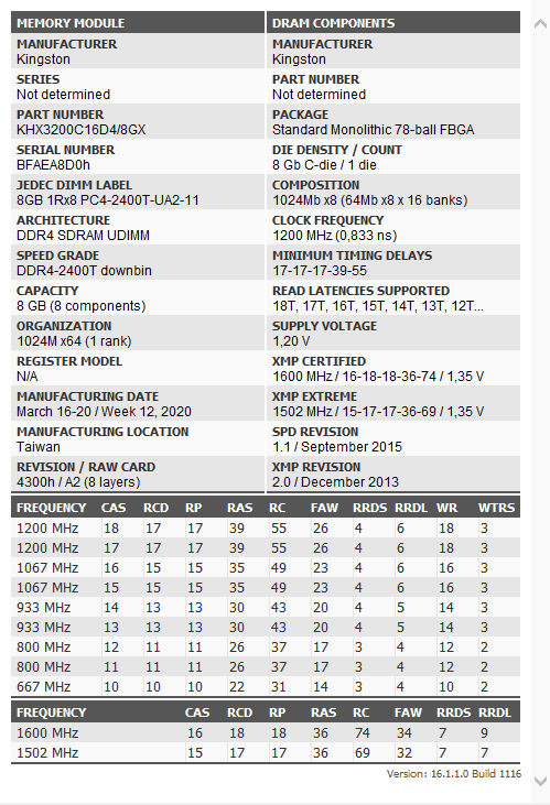

@olan
Sicher dass das Samsung C-Die sind und nicht Hynix C-Die?
@pau1er yea try one pair at a time.
Mach mal bitte ein Foto vom Sticker auf dem RAM.
DPMK0832003
The K stands for SK Hynix. S would be Samsung. This means your IC should be Hynix CJR.
DPMK0832003
That's a good news since according to Rysen DRAM Calculator, Hynix CJR can achieve 3800 while Samsung OEM is only 3466 on a safe preset
I can't believe it but there are 4000 for now with @Maurise preset, and seemingly stable. I'm afraid to raise further to be honest :giggle:
The question is why that can't be achieved on 2 pairs.
Wie in Post 18 schon geschrieben steht K für Hynix. Du solltest also auch Hynix CJR haben.
Edit: Wurde gerade korrigiert. K steht in Wirklichkeit für Relabled as Kingston. Ich habe also nichts gesagt :d

I can't get stable boot to OS with c18-22-42cr2 4100v1.45 and want to stay at safe voltage on the other hand, so I decided to play around 4000 testing only first RAM pair. My current problem: after 5-8 minutes of bench errors arising and if you give it some rest you can repeat test with similar behaviour. Looks like 1.45v is not operable for first pair even with fan. This suitable for all layouts I managed to test, i.e. 4000c18-22-42 and 3600c16-20-32. Current power draw is 4.770W.

If I able to run 4100c18 according to that table, 3600c16 shouldn't be a problem in matter to lower voltage? What timings I have to adjust here at your opinion?
