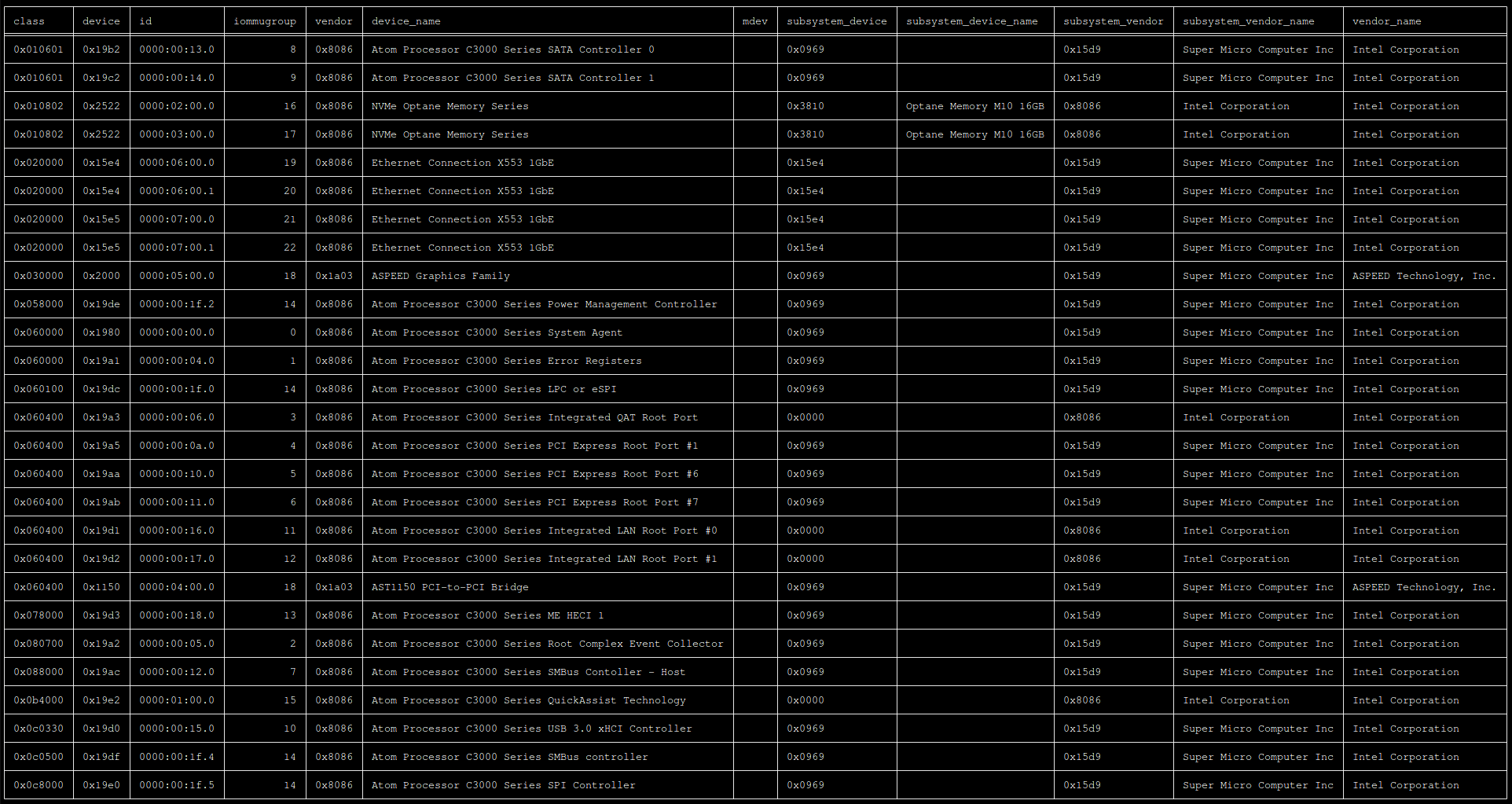

zumindest haben mir die CLI Befehle die ich eingegeben habe gesagt, dass der vom selben Chip kontrolliert wird wie die onboard SATA Ports. Und Passthrough vom Controller bräuchte da ja nen separaten Chip, oder? Zumindest war das wie ich es durch Recherche und LLM verstanden hatte.
Hmja, was fürn Output gibt dir "lspci"? Imho kann man anhand dessen die IMMOU Gruppen erkennen... wenn ich nicht ganz daneben liege.
Code:
00:00.0 Host bridge: Intel Corporation Atom Processor C3000 Series System Agent (rev 11)
00:04.0 Host bridge: Intel Corporation Atom Processor C3000 Series Error Registers (rev 11)
00:05.0 Generic system peripheral [0807]: Intel Corporation Atom Processor C3000 Series Root Complex Event Collector (rev 11)
00:06.0 PCI bridge: Intel Corporation Atom Processor C3000 Series Integrated QAT Root Port (rev 11)
00:0a.0 PCI bridge: Intel Corporation Atom Processor C3000 Series PCI Express Root Port #1 (rev 11)
00:10.0 PCI bridge: Intel Corporation Atom Processor C3000 Series PCI Express Root Port #6 (rev 11)
00:11.0 PCI bridge: Intel Corporation Atom Processor C3000 Series PCI Express Root Port #7 (rev 11)
00:12.0 System peripheral: Intel Corporation Atom Processor C3000 Series SMBus Contoller - Host (rev 11)
00:13.0 SATA controller: Intel Corporation Atom Processor C3000 Series SATA Controller 0 (rev 11)
00:14.0 SATA controller: Intel Corporation Atom Processor C3000 Series SATA Controller 1 (rev 11)
00:15.0 USB controller: Intel Corporation Atom Processor C3000 Series USB 3.0 xHCI Controller (rev 11)
00:16.0 PCI bridge: Intel Corporation Atom Processor C3000 Series Integrated LAN Root Port #0 (rev 11)
00:17.0 PCI bridge: Intel Corporation Atom Processor C3000 Series Integrated LAN Root Port #1 (rev 11)
00:18.0 Communication controller: Intel Corporation Atom Processor C3000 Series ME HECI 1 (rev 11)
00:1f.0 ISA bridge: Intel Corporation Atom Processor C3000 Series LPC or eSPI (rev 11)
00:1f.2 Memory controller: Intel Corporation Atom Processor C3000 Series Power Management Controller (rev 11)
00:1f.4 SMBus: Intel Corporation Atom Processor C3000 Series SMBus controller (rev 11)
00:1f.5 Serial bus controller: Intel Corporation Atom Processor C3000 Series SPI Controller (rev 11)
01:00.0 Co-processor: Intel Corporation Atom Processor C3000 Series QuickAssist Technology (rev 11)
02:00.0 Non-Volatile memory controller: Intel Corporation NVMe Optane Memory Series
03:00.0 Non-Volatile memory controller: Intel Corporation NVMe Optane Memory Series
04:00.0 PCI bridge: ASPEED Technology, Inc. AST1150 PCI-to-PCI Bridge (rev 03)
05:00.0 VGA compatible controller: ASPEED Technology, Inc. ASPEED Graphics Family (rev 30)
06:00.0 Ethernet controller: Intel Corporation Ethernet Connection X553 1GbE (rev 11)
06:00.1 Ethernet controller: Intel Corporation Ethernet Connection X553 1GbE (rev 11)
07:00.0 Ethernet controller: Intel Corporation Ethernet Connection X553 1GbE (rev 11)
07:00.1 Ethernet controller: Intel Corporation Ethernet Connection X553 1GbE (rev 11)
Siehst du da ne Chance für Passthrough?
Meine bescheidene Amateur-Meinung ist folgendes, ich lass mich aber gern verbessern:
Beispiel:
Der erste Block hier lässt sich "durchreichen", also z.B. das angeführte (im Übrigen recht interessante) Gerät, also alles, was auf 01:__.__ hängt.
SATA:
Imho kann man das 00:13._ nicht allein durchreichen, sondern nur mit all seinen "Kollegen" in der 00:xx.x Gruppe, was freilich nicht möglich ist, weil der Kram ja vom OS benötigt wird.
Ich bin mir nicht 100% Sicher, ob ich Mist erzähle, aber probiers einfach. Imho müsste das so sein.

IOMMU Groups kannst du hiermit prüfen:
Okay, das gibt ne ganze Menge Output:
So wie ich das sehe gibt es zwei SATA Controller die in unterschiedlichen IOMMU Gruppen (8 & 9) liegen. Laut MB Manual (Seite 74-75) werden die onboard SATA Ports von Controller 1 kontrolliert und der Mini-SAS Port von Controller 0. Habe ich den Output so richtig interpretiert? Ich werde das auf jeden Fall versuchen durchzureichen. Danke für den Tipp!
Spannend, dann bin ich wohl falsch gelegen, probiers mal... evtl. liegen die ja tatsächlich alle in einer eigenen Gruppe und sind somit einzeln durchreichbar. Hast noch nie probiert vorher?
Ich hatte die Platten durchgereicht, so wie es hier beschrieben ist, habe leider erst danach festgestellt, dass das nicht das ist was man möchte, sondern den gesamten Controller. Dazu hatte ich schon mal recherchiert, war aber zu dem Ergebnis gekommen, dass die SATA Ports (egal ob onboard oder per Mini-SAS) alle an einem Controller hängen. Den Begriff IOMMU habe ich eben zum ersten Mal gehört, aber das sieht ja vielversprechend aus. Ich probiere das nachher mal und werde berichten, ob es klappt! Dann könnte ich mir auch die HBA sparen, die müsste ich nämlich sonst auch erst mal besorgen.
